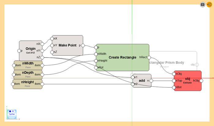

To allow inputs and outputs to the wrapper, the wrapped nodes must be named. In this example, you need to provide access to the origin of the rectangular prism, its dimensions (width, depth, and height), and the resulting extruded object.
Double-click on the wrapper to enter object editing mode and access the Marionette script inside the wrapper.
Select each node listed, and enter its Name in the Object Info palette.
Node
Name
Get XYZ
Origin
Pass (attached to Width input on Create Rectangle node)
Width
Pass (attached to Height input on Create Rectangle node)
Depth
Pass (attached to Add node)
Height
Extrude
obj
Click Exit Marionette Script to return to your drawing. The wrapped network displays with the named nodes that can be accessed.

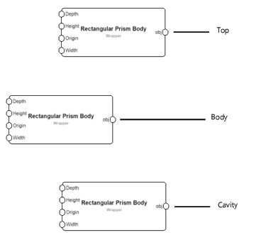

Make two copies of the Rectangular Prism Body wrapper. These will serve as the basis for the cabinet top and cavity in future steps; the parameters will be redefined for each piece of the cabinet.

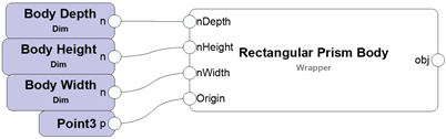

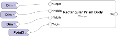

On the original wrapper node (the body), attach a Point3 node to the Origin port and a Dimension node to each of the other ports. Connect the wires.
Select each Dimension node, and assign the following names and dimension values in the Object Info palette.
Body prism port
Dim node name
Value
Depth
Body Depth
2 feet
Height
Body Height
3.5 feet
Width
Body Width
3 feet
Select a node and click Run from the Object Info palette.
The rectangular prism displays with its bottom front left corner at the assigned origin (0,0,0). This is the cabinet body. The prisms that compose the cabinet top and cavity are defined relative to the origin and dimensions of this base object.
