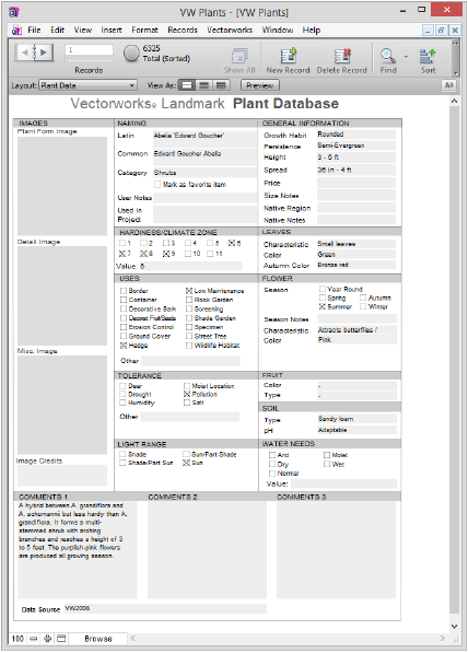

The Vectorworks Plants dialog box may open. Specify a user name for the FileMaker application and its preferences.
The Vectorworks plant database opens in a separate window. Leave it running in the background while you work in the Vectorworks program, for faster communication between Vectorworks and the database.
If you clicked Plant Catalog, a dialog box indicates that Vectorworks is waiting for you to select data from the plant database for the plant style. If you change your mind about obtaining the plant style data from the plant database, click Cancel Data Acquisition.
