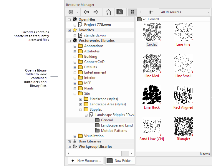

Hundreds of resource libraries are available for use with the Vectorworks application, and you can add custom libraries, as well. In the Resource Manager palette, the file browser pane (on the left) provides easy access to the resource libraries; for even faster access, designate frequently used libraries as "favorites." The Resource Manager lets you view and select the resources contained in library files without opening the files.

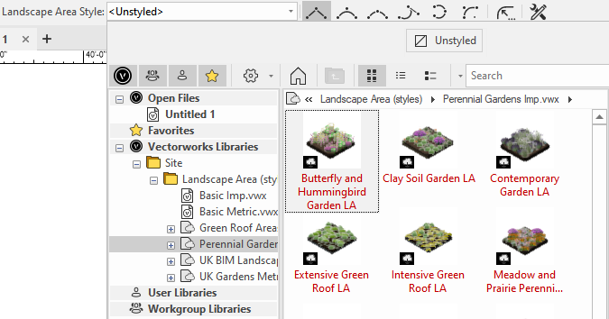

The Resource Selector has a similar browser pane, to provide access to resource libraries at the point of use. For example, you can browse line type resources from the Attributes palette, and browse plant styles (Vectorworks Landmark required) from the Plant tool's Tool bar.
Accessing the Resource Selector from the Tool bar
From both the Resource Manager and Resource Selector, you can drag a library resource to a file in the file browser pane to easily import it. From the Resource Manager, you can also drag a library resource directly onto your drawing.
The Resource Manager and Resource Selector allow you to browse the content online, and they will automatically download the required files on demand. If you work mostly offline and would like to have the content locally available, you can add these libraries during installation, or download them any time with the Vectorworks Package Manager (see Installing Vectorworks libraries locally).
