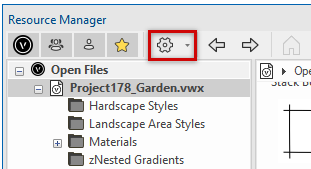

Resource Manager: File browser pane
Files and file libraries
The file browser pane lists open files, favorite files, and various library files from which you can access resources. The Open Files group always displays. Use the buttons on the palette tool bar to show or hide the other file groups.
Group
Description
Open Files
Lists all currently open files
Favorites
Lists all files that you have designated as favorites from the Resource Manager
Vectorworks Libraries
Lists libraries installed or available for download with the Vectorworks program
User Libraries
Lists libraries you place in your User Data and Preferences folder; see Vectorworks preferences: User Folders pane
Workgroup Libraries
(Design Suite product required)
Lists libraries placed in your Workgroup and Project folders; see Sharing custom content using workgroup folders
To quickly expand or collapse a group, click the disclosure arrow next to the group name, or double-click the group heading. To expand or collapse all groups, press the Alt key (Windows) or Option key (Mac) while you click one of the group headings.
Drag the group headings up or down to change the order of the groups. The files in each group are always listed in alphabetical order.
