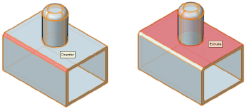

As you move the cursor over the selected object, faces are highlighted, and a screen tip indicates which feature of the solid will be edited if the highlighted face is selected.

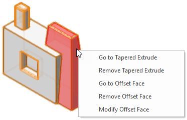

Right-click on a highlighted face to access a context menu with additional options.
If you right-click on the face, a feature-specific context menu displays; select the desired command.
Go to [Feature] enters object editing mode with the selected feature available to edit.
Remove [Feature] immediately removes the selected feature from the object history and rebuilds the solid object.
Modify [Feature], available for fillets, chamfers, shell, and offset face objects, activates the tool that created the feature, to allow editing from the Tool bar; see Modifying a fillet, chamfer, shell, or offset face object for more specific information about editing the edge- and face-specific operations for these objects.
