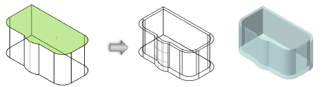

To create a shell solid from a solid object:
Click the tool.
Click Preferences to open the Shell Solid Preferences dialog box and specify the tool’s default parameters. The parameters can be edited later from the Object Info palette.
Parameter
Description
Shell
Inside
Creates an interior shell
Outside
Creates an exterior shell
Thickness
Enter the thickness of the shell wall.
Alternatively, enter a value in the Thickness field on the Tool bar.
Select Tangent Faces
Selects a tangentially connected chain of faces
Click the face of the object where the shell will be created. To select multiple surfaces, press and hold the Shift key while selecting. To select the back faces of solids, press the Alt key (Windows) or Option key (Mac).
See Selecting the edges and faces of a solid for information on selecting surfaces.
Press Enter or click the check mark button on the Tool bar to create the shell.
