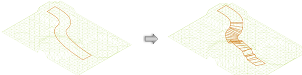

This command is also effective for stakes, 3D loci, 3D polygons, 3D primitives, extrudes, sweeps, meshes, slabs, light objects, walls, and symbols with a 3D component. If a 2D polyline or 2D polygon is selected, it will first be converted into its 3D equivalent before being sent to the surface.
This command also works for Extrude Along Path objects; you can fit the 3D portion of the path object to the surface.

If the object is an Extrude Along Path object, the Send Extrude Along Path to Surface dialog box opens. Select the method of sending the object to the surface.
Parameter
Description
Elevate the object
Elevates the object to meet the surface elevation; path vertices remain unchanged
Fit the path
Fits the path of object to the surface, modifying existing vertices and/or adding new vertices
The Choose Surface dialog box opens. Select the surface where the object should be sent.
The correct Z value is given to the object’s insertion point, bottom-most point, or specified portion, placing the object on the surface.
