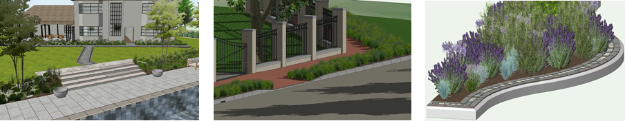

The Curb tool can be used to create a variety of objects including road curbs, hardscape borders, edging, and even coping stones around a swimming pool. They can be freestanding or associated with a hardscape or a landscape area. Curbs can be used to set elevations as site modifiers, and then related objects, such as hardscapes, can be aligned to the curb, or draped over the modified site model.

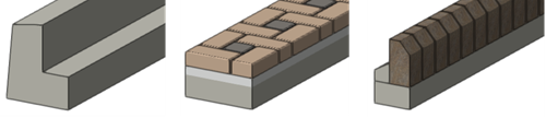

Curbs can be made up entirely of extrudes, entirely of 3D symbols, or of a combination of the two. Often a symbol is used for the visible portion of the curb, but the foundation, haunching and race are created with extrudes. The extrudes are essentially extrudes along path based on profile shapes; they can follow whatever shape the curb path takes.
The curb style on the left is composed only of an extrude, and the two curb styles on the right are composed of extrudes to build the base and the bedding/haunching, and symbols for the top, visible portion
Using symbols as part of a curb allows for detailed reporting and quantity take offs for purchase. However, using curbs composed entirely of extrudes allows a more flexible, simpler workflow, when that level of detail isn't required.

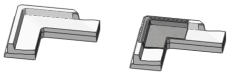

Corners can be specified in the curb style; you can specify different corner symbols or cuts depending on the corner angle. When the curb is drawn, every corner setting can then be replaced or adjusted individually. Insertions such as dropped curbs can also be added to the curb, on a by instance basis. A curb can have as many different corners and insertions as needed.
This curb with a gutter is made entirely of extrudes. On the left it has the default miter corner, and on the right, a corner symbol has been applied.
