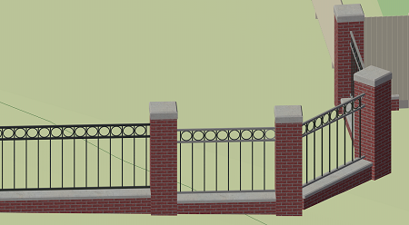

The Fence tool creates various types of raked and stepped fences, including post and rail, picket, wrought iron, tongue and groove, mesh/grid, lattice, chain link, and more. Draw the fence along a specified path using standard polyline creation modes; gates can be added. You can create large runs of fence and display the fence with a lower level of detail during development and then a high level of detail when the design is complete. The fence follows the slope of the surface underneath it.
Alternatively, create a 2D shape and then select the Create Objects from Shapes command (see Creating objects from shapes).

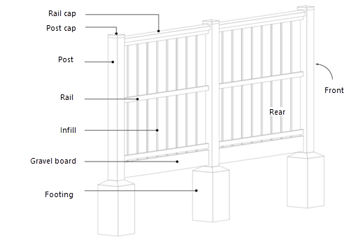

Each fence style can have up to three different types of fence posts: run, corner, and gate. Run posts are in line with the previous segment's post, while corner posts represent a change in direction for the fence segment, or a start/end post. Gate posts are specified by the gate configuration.
For reporting and calculations, the post height is based on its bounding box. Added symbols such as post caps, spikes, shoes, etc. are not considered as part of the post height.
You can create a custom hybrid symbol to use as a post (if you use a 3D symbol, it will not be visible in Top/Plan view). Save the symbol in the current document or your user folder. You can also scale a selected post profile and save it as a resource with the Add as Custom Resource option.

A fence can have as many rails as needed, with a variety of configurations.
Unless they are used as a panel with a stepped fence, "fabric" types of infill such as chain link, snow fence, vinyl mesh, etc. are considered as fabric infill—a type of rail—and are specified from this pane; this allows a fabric infill to follow a raked fence over elevation changes.
If you are creating your own hybrid railing symbol definitions, the rail assembly can consist of several parts. For example, you could have barbed wire at the top of a rail. While all rails have the same offset by default, custom rails can include a locus to allow for a different offset for one of the parts in an assembly.

Add gravel board |
Adds a gravel board to the bottom of the infill. Gravel boards are always centered on the post. |
Board Profile |
Specify the dimensions of the gravel board (Height and Thickness) |
