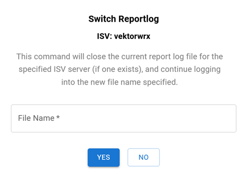

Switching to a different Report log file
You can switch from using the current Report log and specify a different log file. A Report log must already exist to be able to switch to a new one.
Select Switch Reportlog from the Server menu on the server administration Home screen.
The Switch Reportlog screen opens.
In File Name, enter the file path where the log is located, including the filename.
Click Yes.
The Report log switches to the other file.

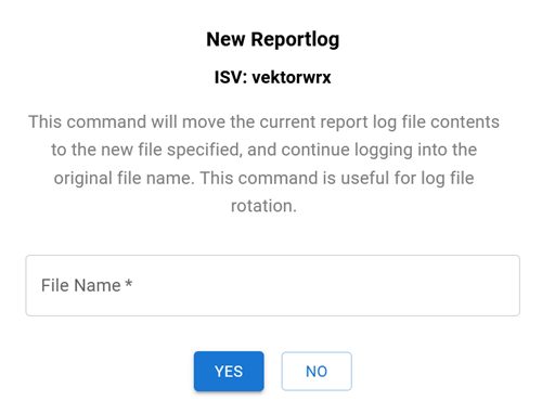

Creating a new Report log
You can save the current Report log file with a different name, and continue using the original file for logging. This is convenient for creating backup files.
The ROTATE command automatically creates backup log files. Depending on the operating circumstances, the log files can become very large; backing up regularly prevents the files from becoming too big. For more information, see Specifying server options.
Select New Reportlog from the Server menu on the server administration Home screen.
The New Reportlog screen opens.
In File Name, enter the file path where the backup log should be located, including the filename.
Click Yes.
The contents of the current Report log file are saved to the specified backup log. Logging continues in the current Report log file.

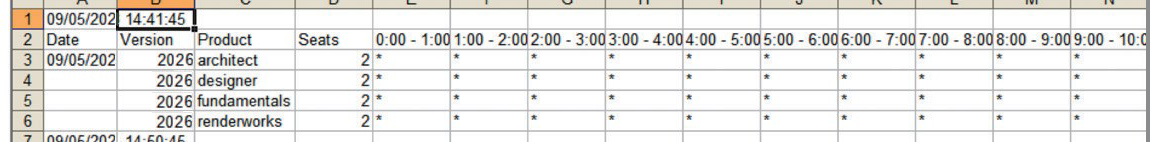

The resulting Excel file can be opened and used for graphing or any type of analysis.
The converted spreadsheet file contains the following information:
Parameter |
Description |
Date |
The date that the statistics were generated |
Version |
The Vectorworks version |
Product |
The name of the Vectorworks module |
Seats |
The number of licenses available per module |
Time intervals |
When a client launches, the number of licenses in use increases. This parameter shows the maximum number of licenses used during each time period. If a license was renewed in the middle of the day, and a specific module was unusable, the unusable time period is indicated by an asterisk (*). The next day, it will not appear in the statistics. If the number of licenses changes in the middle of the day, the new value will be reflected at the end of the day (when the date changes). |
Borrow |
Indicates the number of borrowed licenses at the end of the day (when the date changes) |
