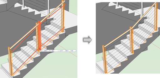

Move Post Along Path
Moves the post along the railing line, depending on spacing and style settings

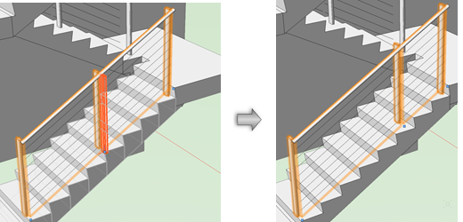

Move Post Vertically
Moves the post vertically

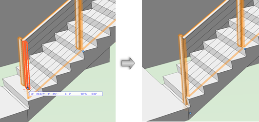

Reshape Bottom of Post
Changes the post length; press the Shift key while dragging to constrain the post length adjustment along the same vertical line
