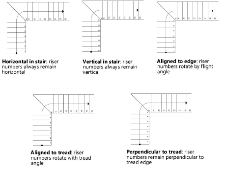

Rotation
Specifies the rotation of the riser numbers
