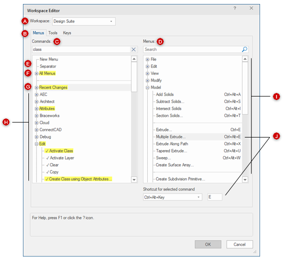

Click the Menus tab, or the Tools tab, depending which part of the workspace you want to modify. The list on the left side of the dialog box contains all the commands/tools available with the current license. The list on the right side of the dialog box shows the organization of the commands and tools in the workspace currently being edited. The Menus tab is shown in this example, but the Tools tab offers the same functionality.
A: List of workspaces and action options to manage the workspace list; the name of the workspace being edited displays
B: Select whether to edit the menus and commands, the tool sets and tools, or the keyboard shortcuts for functions that are not connected to a command or tool
C: Lists all commands/tools available with the active serial number; a check mark beside the item name indicates it is already present in this workspace listed to the right. When searched, all categories and all items with the search term highlight in the list.
D: Lists all commands/tools and their locations in this workspace; when searched, all categories and all items with the search term highlight in the list
E: Add a menu, tool set or separator
F: All available items, listed alphabetically
G: Items recently added to the workspace, revised, and removed to legacy
H: All available items, listed by category (the category is not the same as the menu or tool set, as an item's location can vary depending on the workspace)
I: All items in this workspace, listed by location
J: Select an item to edit its keyboard shortcut
