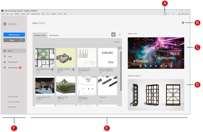

The Home screen provides a single point of access to a variety of files, videos, and other resources for learning and using Vectorworks. You can use the Home screen to create and open files, and when the Home screen is active, the Vectorworks menus are accessible and behave as they do when there is no open file. Depending on your Vectorworks preferences and how you launch the program, the Home screen may open automatically on startup; see Vectorworks preferences: Session pane.
To toggle between the Home screen and the work area at any time, select the command or click the icon on the top right of the Title bar (Mac) or Menu bar (Windows).
The work area automatically displays when you open a file from the Home screen, or when you drag and drop a file onto any part of the Home screen or onto the Vectorworks icon on the dock (Mac).
The Home screen automatically opens to the Home pane.
A: Toggles between the Home screen and work area (main application)
B: Opens the online help system
C: Links to information about new videos, features, events, webinars, and more
D: Opens sample files on Vectorworks University
E: Content panel
F: Side bar
The side bar lets you open Vectorworks files, select what kind of content to display in the Home screen's content panel, and link to external resources.

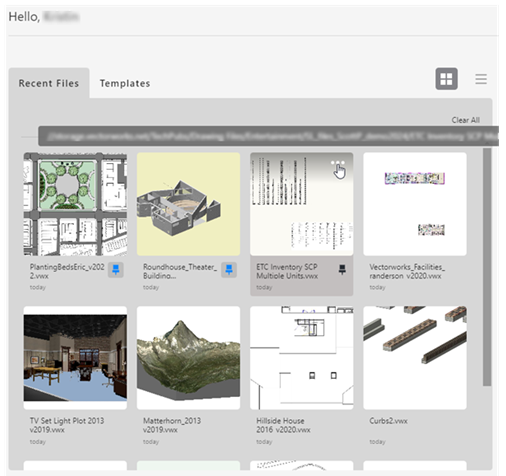

Recent Files tab
Displays the recently used file name, a thumbnail view, and the date the file was last opened. By default the files display in the order they were last opened (most recent first), but you can pin files to display first in the tab; pinned files display a highlighted pin. When there are multiple pinned files, they display in the order they were last used.
Hold the cursor over a file to display the file path. In grid views, holding the cursor over the file also displays the file menu in the upper right corner of the file, and for unpinned files, a black pin; click it to pin the file and move it earlier in the list. The menu and pin are always visible in list view. In list view, the file size also displays.
Click a file to open it.
File Menu
Click the menu button to display the commands:
Pin/Unpin File changes the pinned status of the file; alternatively click the pin icon to change the status.
Clear Recent File removes the selected file from the Recent Files list here and under the Open Recent command in the File menu.
Show in Explorer (Windows)/Reveal in Finder (Mac) opens the folder containing the selected file.
Clear All
Removes everything from your list of recently opened files, here and under the Open Recent command in the File menu
