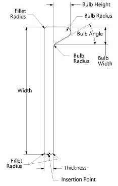

Width
Displays the bulb flat width, or if Custom Size is selected, allows entry of a custom value
Thickness
Displays the bulb flat thickness, or if Custom Size is selected, allows entry of a custom value
Bulb Height
Displays the bulb height, or if Custom Size is selected, allows entry of a custom value
Bulb Width
Displays the bulb width, or if Custom Size is selected, allows entry of a custom value
Bulb Radius
Displays the bulb radius value, or if Custom Size is selected, allows entry of a custom value
Fillet Radius
Displays the fillet radius value, or if Custom Size is selected, allows entry of a custom value
Bulb Angle (Deg.)
Displays the bulb angle in degrees, or if Custom Size is selected, allows entry of a custom value
