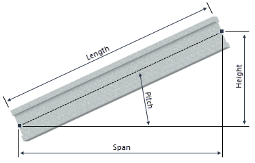

For linear insertion-type structural members, you gain additional control by using the Selection tool, which allows you to press the Tab key to access the Data bar and change the Span, Angle, Pitch, Length, and/or Height. These parameters are interdependent, so that editing one typically changes one or more of the others. They can also be edited in the Object Info palette. To constrain linear insertion objects to the current 3D path angle, press and hold the Shift key while dragging the start and end points with the Selection tool.

Span/Pitch/Length
These parameters, along with Height, are interdependent, so that editing one typically changes one or more of the others
