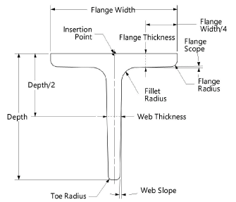

Custom Size |
Select this option to enable fields for specifying a custom tee size |
Depth |
Displays the depth between endpoints, or if Custom Size is selected, allows entry of a custom value |
Flange Width |
Displays the flange width, or if Custom Size is selected, allows entry of a custom value |
Web Thickness |
Displays the web thickness, or if Custom Size is selected, allows entry of a custom value |
Flange Thickness |
Displays the flange thickness, or if Custom Size is selected, allows entry of a custom value |
Web Slope (Deg.) |
Displays the web slope in degrees, or if Custom Size is selected, allows entry of a custom value |
Flange Slope (deg.) |
Displays the flange slope in degrees, or if Custom Size is selected, allows entry of a custom value |
Toe Radius |
Displays the toe radius value, or if Custom Size is selected, allows entry of a custom value |
Flange Radius |
Displays the flange radius value, or if Custom Size is selected, allows entry of a custom value |
Fillet Radius |
Displays the fillet radius value, or if Custom Size is selected, allows entry of a custom value |
