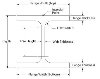

Click to place the object in the drawing, and click again to set the rotation. The first time you use the tool in a file, a properties dialog box opens. Set the default parameters. The parameters can be edited later from the Object Info palette.
Parameter |
Description |
Series |
Select the desired series to display the appropriate nominal sizes |
Size |
Select the wide flange size |
Length (Design Suite product required) |
Enter the length of the 3D wide flange |
Draw Center Line |
Select whether to draw the 2D wide flange with center lines |
Draw Free Height Lines |
Select whether to draw the 2D wide flange with free height lines |
Place Locus at Centroid |
Select whether to draw a locus at the centroid of the 2D wide flange |
Lock Centroid Position |
Locks the centroid position; when locked, the centroid behaves like the object’s insertion point and remains in position if the object’s shape/size/rotation is edited |
Custom Size |
Select this option to enable fields for specifying a custom wide flange size |
Depth |
Displays the depth between endpoints, or if Custom Size is selected, allows entry of a custom value |
Flange Width (Top)/(Bottom) |
Displays the top and bottom flange width of the wide flange, or if Custom Size is selected, allows entry of a custom value |
Web Thickness |
Displays the web thickness, or if Custom Size is selected, allows entry of a custom value |
Flange Thickness |
Displays the flange thickness, or if Custom Size is selected, allows entry of a custom value |
Fillet Radius |
Displays the fillet radius value, or if Custom Size is selected, allows entry of a custom value |
