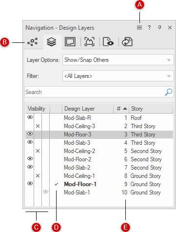

The Navigation palette provides access to classes, design layers, sheet layers, viewports, saved views, and references, similar to the Organization dialog box. However, unlike the Organization dialog box, the drawing area is accessible while the Navigation palette is open.
To use the Navigation palette:
Select the command. The Navigation palette opens. In the following example, the Design Layers tab is active.
A: Utility menu (commands vary by active tab)
B: Tabs (Classes, Design Layers, Sheet Layers, Viewports, Saved Views, References)
C: Visibility settings
D: Active class/layer (classes, design layers, and sheet layers tabs only)
E: Stacking order (design layers and sheet layers tabs only)
F: Assigned tags (classes, design layers, and sheet layers tabs only)
