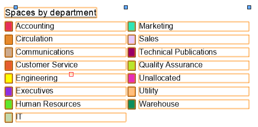

Data visualization legends
When a data visualization is assigned to a sheet layer viewport, a legend can be automatically created, edited, or deleted within the annotation layer of the viewport (unless the data visualization and its legend are controlled by the viewport style). If multiple visualizations are selected for the viewport, a legend can be created for each visualization. Click Create data visualization legend when creating the viewport or in the Object Info palette of a selected viewport to toggle the legend on or off.
Control points at the top of the legend adjust the spacing between the swatches and labels, and the overall legend width
