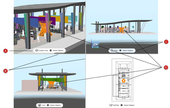

A: A pane title flag on each pane describes its view and layer name
B: Pane splitters divide and resize view panes
C: The Onscreen View Control and a blue highlighted pane title flag indicate the active view
D: Selected objects are highlighted in all view panes with a similar perspective
