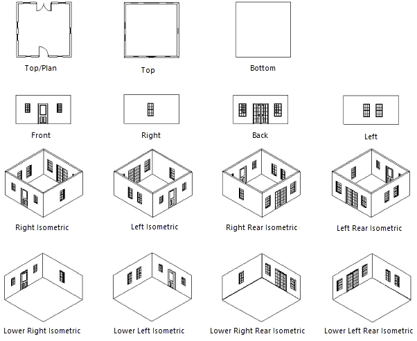

Vectorworks provides several standard views, which change the representation and the orientation of the drawing area, so you can easily view the model from a variety of different angles. The standard view options can be divided into four basic categories:
Category
Description
2D view
The Top/Plan view displays the drawing in 2D; use this for annotations, title block borders, and 2D illustrations.
3D primary views/elevations
The Top, Front, Right, Bottom, Back, and Left views display 3D primary views/elevations
3D representations above the layer plane
The Right Isometric, Left Isometric, Right Rear Isometric, and Left Rear Isometric views display isometric 3D representations from above the layer plane
3D representations below the layer plane
The Lower Right Isometric, Lower Left Isometric, Lower Right Rear Isometric, and Lower Left Rear Isometric views display isometric 3D representations from below the layer plane
