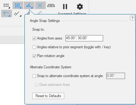

Most snapping tools have settings that can be set from a popover that opens when you double-click, right-click, or click and hold the tool. Most of these settings are considered application settings and apply to any file opened in the Vectorworks program. Certain settings are considered document settings and are saved with the file; these include grid dimensions, alternate angle extension lines, datum and smart edge offset, and distance snap settings. Some of the snapping tools do not have additional parameters and are simply toggled on or off.
Double-click, double-tap the snapping shortcut key, or click and hold snapping tools that have an arrow in the lower-right corner to open a popover with settings for that snapping type. Click Snapping Settings on the right to open the General Snapping Settings popover. Click anywhere outside a popover to dismiss it.

Click Snapping Settings  in the Snapping set to open the General Snapping Settings popover and set the parameters that are not specific to any tool.
Double-click, double-tap the snapping shortcut key, or click and hold a tool in the Snapping set to open the settings popover for that snapping type, and set parameters for that tool. Some of the tools do not have a settings popover.
