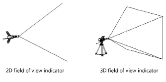

Show Field of View |
Select how to display the field of view indicator, which provides an idea of what the camera will capture, from an inactive camera view
