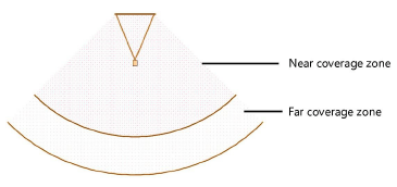

Show coverage zone (2D only) |
Indicates the viewing area based on the screen size; observers within the area should be able to see the screen
Settings |
Zone Reference |
Calculates the coverage zone based on screen width, height, or diagonal measurement |
Max Horiz. Angle/ Max Vert. Angle |
Indicates the maximum viewing angle of the screen, horizontally and vertically, relative to dead-on |
Viewing Height |
Enter the height of the average viewer when watching (likely, a seated height) |
Near Multiplier |
Specifies the multiplier of the reference dimension to determine the extent of the near coverage zone |
Far Multiplier |
Specifies the multiplier of the reference dimension to determine the extent of the far coverage zone |
