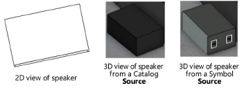

Insert by Symbol
Inserts a speaker symbol from the resource library; symbol resources include preset data and detailed geometry for visualization, but respond more slowly to edits such as rotating the object
Insert by Catalog
Inserts a speaker from the speaker catalog; catalog resources include preset data and a basic box of the correct size to respond quickly and efficiently to edits such as rotating the object

Source
Select whether the speaker is a symbol from the resource library or an item from the catalog

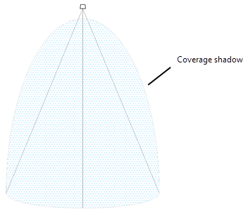

Show dispersion range 1/2/3
Draws the top, bottom, left, and right dispersion lines, along with a center reference line, for each of the three dispersion ranges selected for display (or the Overall range if expanded dispersion is not selected). An outline or hatch pattern representing the listening area coverage "shadow" is drawn when the throw distance and the vertical dispersion and tilt angles allow the speaker to cover the area at or below the Listening Height.
Show dispersion hatch
Displays hatch fills in the coverage shadow of each enabled dispersion range
