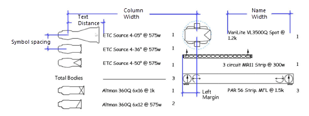

Equipment Summary Key Layout Settings |
Set up the desired layout settings for each type of summary default: Equipment or Positions (hanging position), selected from the Summary Defaults |
Column Settings |
Left Margin |
Sets the distance from the left of the summary insertion point to the bounding box of the displayed symbol |
Column Width |
Sets the total width of each column, in document units |
Text Distance |
Sets the distance between the end of the bounding box to the text description |
Name Width |
Sets the maximum width of descriptive text before it wraps |
Counts Width |
Sets the maximum width of the count column |
Column Spacing |
Sets the distance between columns |
Symbol Spacing |
Specifies the vertical distance between symbols. Additional distance is automatically added if the symbol is larger than the spacing. |
