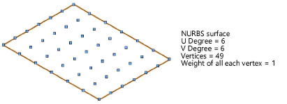

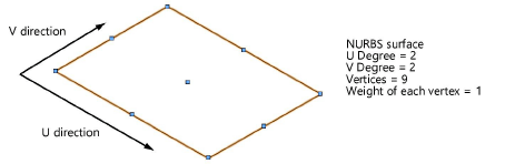

The same principles that apply to a NURBS curve apply to a surface. A NURBS surface is a grid, or mesh, of weighted control points in the U and V directions.
Increasing the degree of a NURBS surface in the U and/or V direction increases the number of vertices, adding flexibility as well as complexity.

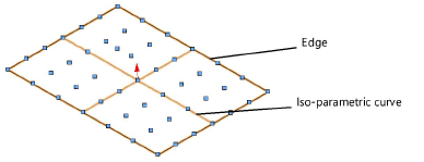

A NURBS surface also has a direction, or normal, which affects the outcome of certain operations, such as fillet surface creation. Iso-parametric curves indicate the U and V direction, and edge curves are drawn along the edges, helping to visualize the NURBS surface.

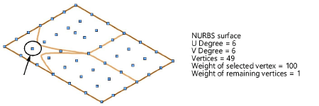

Each vertex on the surface can have a weight which "pulls" the surface towards the weighted vertices.

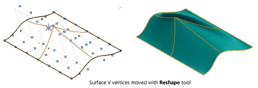

The Reshape tool can move a single vertex or a row of vertices, deforming the surface (see Reshaping NURBS surfaces).

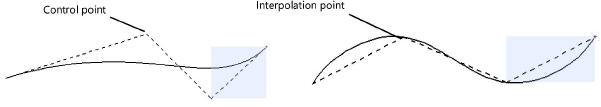

Both NURBS curves and surfaces can be defined by control points or by interpolation points. The curve or surface passes between control points or through interpolation points.
Interpolated curves and surfaces may be easier to modify. See Creating NURBS curves and Interpolated NURBS surfaces.
