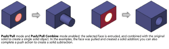

Extruding planar objects on the face of a solid object
Planar objects that are placed on the face of a solid can be used to create new faces to extrude, and optionally combined with the existing solid to create a single solid object. Planar objects can be used to create new faces to model with push/pull actions in the following ways:
The planar object itself can be extruded.
The planar object can be used to exclude an area for extrusion, and the face surrounding the object can be extruded.
Extrusion of the selected face can be combined with the existing solid to create a solid addition or a solid subtraction.
The push/pull actions affect the selected face of the solid object, but do not go through the entire existing solid. See Solid object interactions for other ways to add to or subtract from solids.

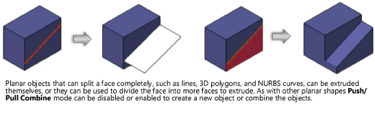

Planar objects can completely split a face to define additional faces for push/pull actions.
A solid object face that is not completely split by the planar object cannot be extruded using Push/Pull mode; however, the planar object can be extruded. Non-planar faces cannot be extruded.
