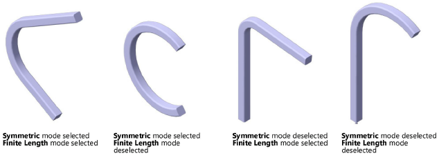

Symmetric mode is selected by default; the bend applies to both the positive and negative direction of the bend spine. If an asymmetrical bend is desired, deselect Symmetric mode on the Tool bar; the bend applies only to the positive direction of the bend spine.
Finite Length mode is selected by default; the bend applies only to the finite length of the bend spine. To bend the entire object, deselect Finite Length mode on the Tool bar.
The Symmetric mode and Finite Length mode status can also be changed at any time during the operation.

Example with Symmetric and Finite Length modes selected
