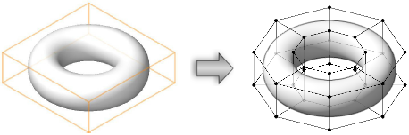

When the Edit Subdivision tool is clicked, the selected subdivision object's bounding box is replaced by a cage mesh with faces, edges, and vertices that can be edited
