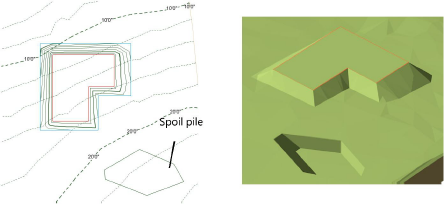

A spoil pile refers to an area where excess earth is used to help balance the cut and fill, so that the site does not require earth to be moved in or out. A spoil pile area applies an even thickness of cut or fill for the site. To create a spoil pile, either use the Site Modifiers tool, or draw a polyline and then select the Create Objects from Shapes command (see Creating objects from shapes).

Draw the spoil pile area.
In the Object Info palette, adjust the elevation of the spoil pile up or down depending on whether fill is required or excess fill is present.

Evaluate the results of the spoil pile by checking the Net C&F Volume results in the Object Info palette of the selected site model. If the spoil pile elevation needs adjustment, select the spoil pile and enter a new Elevation value from the Object Info palette. Then select the site model, click Update, and then click Update Cut and Fill Calculations.
Continue adjusting the spoil pile elevation until a balanced cut and fill volume is achieved.
Display a 2D representation of the cut and fill volumes as an overlay on the site model by selecting 2D cut and fill map overlay from the Object Info palette of a selected site model. The properties of the map overlay are specified in the selecting 2D Cut and Fill Map on the Site Analysis tab of the Graphic Properties dialog box.
Display the 3D cut and fill volumes on the site model by selecting Cut and Fill as the 3D Display from the Object Info palette of a selected site model. The cut and fill colors are specified on the Site Model tab of the Graphic Properties dialog box.
