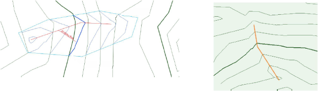

An open edge line modifier is an open 3D polygon which modifies the site model, and represents an open line at a constant elevation. The modifier can be applied to the existing or proposed site model. Draw the line with the Site Modifiers tool, or draw a polyline and then select the Create Objects from Shapes command to change it to a line object (see Creating objects from shapes).

Normally, create grade limits around the open edge line.
To reflect the modification, click Update Site Model from the Object Info palette.
Open edge line modifier with grade limits
