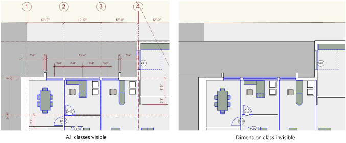

Classes can be used to control visibility. For example, the classes shown for a review of the overall event design impede the clear view needed by the people who install individual components. In this case, you could assign lighting devices to the "Lighting" class, then make the class invisible in the documentation given to the rigging installers. This allows the same file to be used for all stages of a project and for various purposes.

As objects are created, they are normally assigned to the active class. The active class is highlighted in bold text on the Organization dialog box, Navigation palette, and the Classes list in the View bar. Note that the active class may not be displayed at all, if you have applied a filter to the list.
Each new drawing created with the Vectorworks program automatically has two classes: Dimension and None. None is the default active class. Any dimensions created are assigned, by default, to the Dimension class (this is a preference setting that can be changed; see Document preferences: Dimensions tab). These two classes can be renamed but not deleted.
