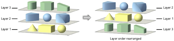

Design layers are stacked by default in the order they are created (with new layers placed on top), but the stacking order can be changed. Reorder the layers to move all of the objects contained within each layer to another location without actually modifying the objects or their placement on the layer.

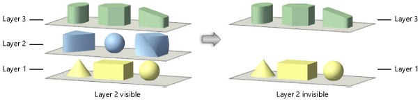

Design layers can be visible, invisible, or grayed. Create design layers with objects that should always display, or layers that contain objects for display only at particular times. Control the visibility of the design layers to limit the need for creating new objects. Sheet layers always show only the active layer.
