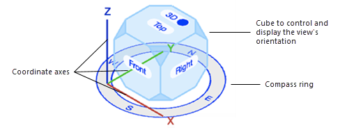

The Onscreen View Control
The Onscreen View Control displays in the lower left corner of the drawing area by default (and can be moved to any chosen corner) for design layers. It lets you quickly change among standard views, or drag to execute a flyover and set custom views. Depending on the settings, the Onscreen View Control also provides visual cues to the drawing orientation, including coordinate axes, a compass ring, and indicators for a rotated Top/Plan view and/or when the view is set relative to the working plane. Zooming with the mouse wheel when the cursor is located over the cube uses the drawing area as the zoom origin, rather than the cursor position.
When View is Relative to Working Plane is enabled, the Onscreen View Control orients itself so the bottom face of the cube is parallel to the working plane, and the bottom face displays in a color to reflect the working plane alignment.

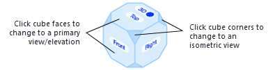

Standard views
Use the Onscreen View Control to change among standard views from within the drawing area (see Using standard views).
To change to a standard view, do any of the following:
Click any cube face or angled corner to change to the associated standard view.
To change to Top/Plan view, click the 2D/3D toggle on the Top cube face from any view where it is visible; you may need to change the current 3D view to make the Top face visible.
If there is a rotated Top/Plan view available, the 2D toggle activates that rotated view (see Rotating the plan).
To change to a primary standard view from an occluded side of the cube, hold the cursor over the nearest edge of the cube face until the occluded side's edges are highlighted, and then click. Isometric views set by occluded corners cannot be directly selected; change first to a view that makes the necessary cube corner accessible.
To change to the view directly opposite the current standard view, click on the current view face or corner.
The Current View list on the View bar shows the name of the current view.

You can set which parts of the Onscreen View Control display, and change its size and the colors of some parts.
To control the visibility of the Onscreen View Control parts:
Move the cursor toward the lower left corner of the drawing area (whether the Onscreen View Control is currently visible or not) until the menu button displays; click the button.
The Onscreen View Control Settings popover opens.
These are application settings, not document settings.
Parameter
Description
Show Onscreen View Control
Displays all or part of the Onscreen View Control as indicated by the selections below
Show axes
Displays the X/Y/Z or X'/Y'/Z' axes, depending whether the axes are relative to the layer plane or working plane
Show compass ring
Displays the compass ring, if the file has been georeferenced and geolocated; see Specifying georeferencing and geolocation. The compass ring is for informational purposes only, and can't be used to change settings.
The compass ring is available for display only when the file is geolocated and contains a survey point.
Show cube
Displays the cube
Position
Select the display location for the Onscreen View Control. When other onscreen elements, such as buttons and temporary tool palettes in object editing mode, conflict with the Onscreen View Control, the Onscreen View Control's position takes precedence.
