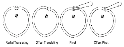

DesignSeries00169.pngCam Design

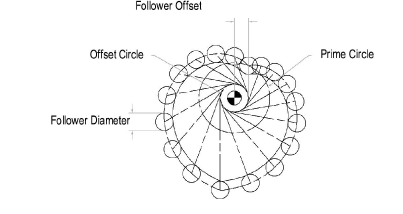

The cam object, which is created using one of the Cam templates provided with the Vectorworks software, can be animated and generates cam data worksheets and diagrams.
The recommended procedure to include a cam in an existing Vectorworks drawing is to create it in a separate document, then copy and paste it into the drawing, and convert it to a group by selecting it and selecting Modify > Convert > Convert to Group.
To create a cam object:
  1. Select File > New.
  2. The Create Document dialog box opens.
  3. Select Use document template, and choose the Cam (Imperial).sta or Cam (Metric).sta template.
  4. Click OK. The new file opens, with a cam inserted by default. The file contains Cam and Diagrams layers. The cam object is a point object; its properties can be edited from the Object Info palette.
