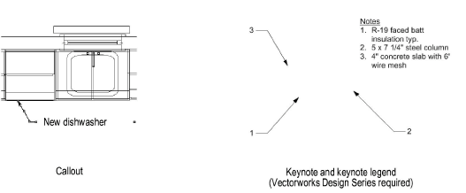

The Callout tool places callout objects on a drawing. A callout object is a block of text attached to one or more leader lines with an optional bubble surrounding the text. Use callout objects to annotate items in a file. You can create callout objects with multiple leader lines by Editing a Callout Object.
In the Vectorworks Design Series products, the Callout tool includes extended capabilities which allow it to be used for keynotes. A keynote legend is automatically created.
A keynote can be used without a database as described in this section, or in conjunction with an external notes database (see Placing Database Callouts).

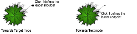

Mode
Description
Towards Target
Click first where the callout text is to be placed, and place the final click on the object to be annotated
Towards Text
Click first on the object to be annotated, and place the final click where the callout text is to be placed

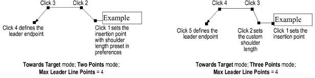

Two Point
The length of the shoulder is determined in the callout preferences or in the Object Info palette
Three Point
The length of the shoulder is determined by clicking in the drawing area; this requires an additional click.
For example, if Max Leader Line Points is set to 2, three clicks are required to place the object with a custom shoulder length, and if Max Leader Line Points is set to 5, six clicks are required.
Enter the maximum number of leader line points for this callout object. If the object has multiple leader lines, each line can have a different number of points; double-click to end a leader line that has fewer than the maximum allowed number of points.

  5. Click the desired insertion modes from the Tool bar, and then click in the drawing to set the insertion point of the callout or keynote object.
  6. Depending on the mode, the first click defines the leader shoulder or the leader endpoint.
  7. Continue clicking to set vertices and shape the leader line, as many times as permitted by the Max Leader Line Points value; double-click on the final point if this leader line requires fewer than the maximum number of points. The final click sets either the leader endpoint or leader shoulder, depending on the mode.
  8. If in Three Point mode, you can custom set the shoulder length by clicking in the drawing area; this requires one additional click.
    The Notes Manager: Callout dialog box opens. Enter the callout or keynote legend text; text wraps if longer than the specified maximum text width. Press Enter to add a line in the text.
  9. Click OK.
The callout or keynote is placed in the drawing; if a keynote is placed, a keynote legend object is also created.
