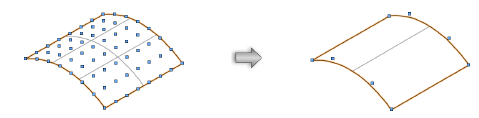

The number of vertices in one or more selected NURBS curves or untrimmed surfaces can be changed with the Rebuild NURBS command. Reducing vertices simplifies the geometry, making it easier to manipulate, and increases the speed and ease-of-use for other objects that are based upon it.
To rebuild a NURBS curve or surface:
  1. Select the NURBS curve or surface.
  2. Select Model > 3D Power Pack > Rebuild NURBS.
  3. The Rebuild NURBS dialog box opens. Enter the number of points to use; specifying fewer points simplifies the NURBS curve or surface, but increases the difference between the original geometry and the rebuilt geometry.
  4. Click OK to rebuild the NURBS curve or surface.
