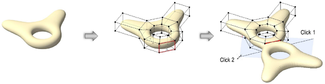

As you move the cursor over the cage mesh, its faces and open edges are highlighted to indicate they can be projected to the mirror plane. An open edge is an edge with only one adjacent face; this means that the cage mesh’s other adjacent faces have been completely deleted from the drawing using the Transform mode and the Delete key.
Select one or more faces and open edges to project across the plane.
Click to set the beginning of the axis line. As you begin to drag the cursor to create the axis line, a preview of the mirrored object’s placement displays. Click again to set the end of the line.
A second half of the subdivision object is mirrored across the plane.

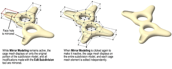

Leave Mirror Modeling active to continue to mirror edits across the plane as you make them to the original portion of the object, or click Mirror Modeling from the Tool bar to make it inactive and edit only one portion of the object at a time.
The cage mesh displays on only the original portion of the subdivision object as long as Mirror Modeling is turned on. Once the mode is turned off, the cage displays on the mirrored portion, too.
