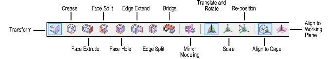

The tool’s modes allow you to combine many different operations to sculpt a selected subdivision object into almost any shape imaginable. When the Transform mode is selected, additional modes are available for manipulating the object.

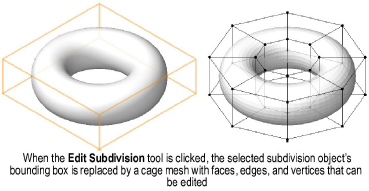

Double-click the subdivision object with the Selection tool to select the object and automatically activate the Edit Subdivision tool.
Mode
Description
Transform
Uses a 3D dragger to transform cage mesh faces, edges, and vertices in a variety of ways depending on the additional modes selected
Crease
Edits the sharpness of the cage mesh’s face, edge, or vertex to produce a smooth or sharp object
Face Extrude
Extrudes a cage mesh face, similar to the Push/Pull tool
Face Split
Splits a cage mesh face into five faces to create new cage mesh entities to edit
Face Hole
Creates a hole in a subdivision object’s face
Edge Extend
Extends an open edge of the subdivision object
Edge Split
Splits a cage mesh along an edge to create new cage mesh entities to edit
Bridge
Connects two open edges of a subdivision object
Mirror Modeling
Mirrors a subdivision model across a plane
Translate and Rotate
(Transform mode only)
Uses the Translate and Rotate 3D dragger to manipulate cage mesh faces, edges, and vertices to reshape and rotate the selected object
Scale
Uses the Scale 3D dragger to change the scale of the selected object or a designated part of the selected object
Re-position
Repositions the 3D dragger without affecting the selected object
Align to Cage
Keeps the 3D dragger aligned to the selected cage mesh entity
Align to Working Plane
Keeps the 3D dragger aligned to the working plane (see Concept: Understanding the Working Plane)
After the operation is complete, the Edit Subdivision tool and selected cage mesh entity remain active, to facilitate beginning another operation. Click another mode, cage mesh entity, or 3D dragger control to begin another edit.
After editing, the subdivision object can be converted to a generic solid or NURBS object; see Converting to Generic Solids and Converting to NURBS.
