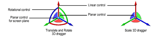

The Transform mode of the Edit Subdivision tool allows you to perform a variety of operations on a subdivision object, depending on the additional modes selected. The Translate and Rotate mode activates a 3D dragger with linear, planar, and rotational handles to reshape the selected face, edge, or vertex of the cage mesh. The Scale mode activates a 3D dragger with linear and planar handles that allow you to scale the selected face, edge, or vertices of the cage mesh.

Three additional modes make it easy to select the portion of the cage mesh to be edited. The Re-position mode allows you to reposition the 3D dragger without affecting the selected object. The Align to Cage mode keeps the 3D dragger aligned to the selected cage mesh entity, and the Align to Working Plane mode keeps the 3D dragger aligned to the working plane.
