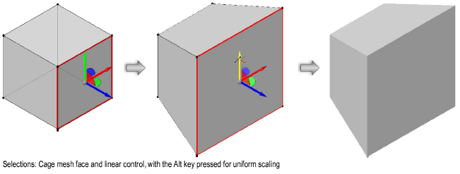

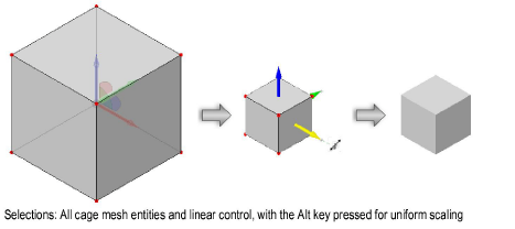

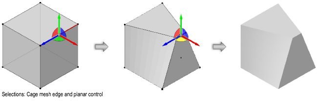

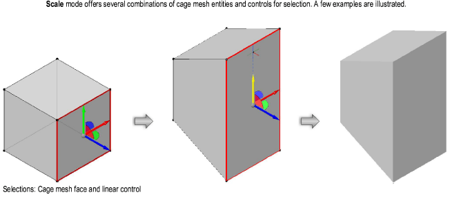

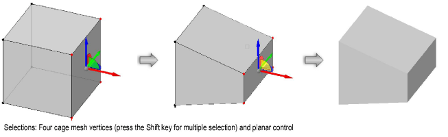

Click on a cage mesh entity to place the Scale 3D dragger. To select multiple cage mesh entities, Shift-click, or Shift-drag to create a marquee selection. For multiple selections, the 3D dragger is placed in the center relative to the selected entities and oriented to the current working plane, regardless of which alignment mode is selected.
The 3D dragger displays only when a cage mesh entity is selected.
Use Re-position mode if needed to move the 3D dragger to the desired location (see Repositioning the 3D Dragger).
Click on the 3D dragger’s appropriate linear or planar control and move the dragger to change the object’s scale. As you move the dragger, the new shape previews.
To scale an object uniformly in all directions, press the Alt key during the operation.
The selected control displays in yellow during the operation.
Click to complete the transformation.
