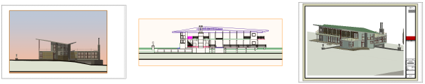

Viewports can display entire, as well as cropped, views of a drawing, with specified layer and class visibility settings, projection, render mode, and orientation parameters (complete with details, annotations, dimensions, and title block borders). Viewports can show other parts of the active document, or even portions of other documents. If the drawing changes, update the viewports to reflect the changes.

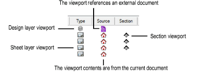

The Viewports tab of the Organization dialog box differentiates among the various types of viewports.
