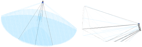

From the Object Info palette, click Populate Array to add the speakers to the drawing.

Show Dispersion for Range 1/2/3 |
Draws the top, bottom, left, and right dispersion lines for each of the three dispersion ranges selected for display, for each speaker (or the Overall range if expanded dispersion is not selected). When applicable, a center reference line is drawn for each of the three dispersion ranges, for each of the speaker models in the array. An outline or hatch pattern representing the listening area coverage “shadow” is drawn when the throw distance and the vertical dispersion and tilt angles allow the speaker to cover the area at or below the Listening Height.
Show Dispersion Hatch |
Displays hatch fills in the coverage shadow of each enabled dispersion range |
