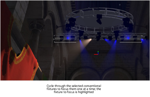

To focus selected conventional fixtures one at a time:
1. Select the fixtures to focus. The selected fixtures automatically output light in the Scene window.
2. Press the Page Up or the Page Down key to traverse the selected fixtures, based on their order in the Scene Graph palette.
Press the Page Down key to focus the first selected fixture and to cycle down the list. Press the Page Up key to focus the last selected fixture and to cycle up the list.
The fixture to focus displays its normal light beams, while the other fixtures emit blue light.
3. Use the arrow keys to pan and tilt the highlighted fixture to achieve the desired focus.
4. Continue pressing the Page Up or the Page Down key to traverse the selected fixtures. Use the arrow keys to focus each fixture as needed.
When the cycle is complete, all selected fixtures display their normal light beams.
