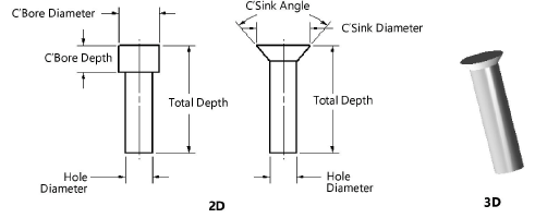

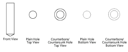

Both 2D and 3D drilled holes are available. The 3D drilled hole is a solid object that can be subtracted from any other solid object to create accurate 3D models of molds, dies, and many other machine parts (see Subtract solids).
