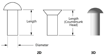

To insert a rivet (DIN):
1.      Click the tool and mode.
2.      Click to place the object in the drawing, and click again to set the rotation.

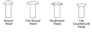

Large rivets
Small rivets
Tubular rivets
