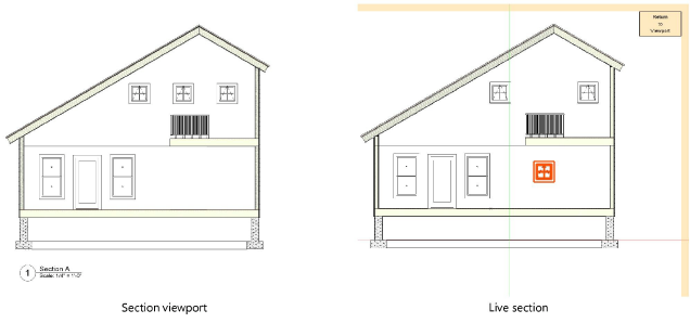

The Edit In-Place mode edits design layers in a live section, or in a live elevation (Vectorworks Architect required). The visual context of the live section or elevation (its view orientation, projection, rendered appearance, and visibilities) matches its source viewport, for a seamless transition to editing.

A colored border around the drawing window indicates that you are in an editing mode. The Return to Viewport command becomes available from the Modify menu, and the Return to Viewport button is visible in the top right corner of the drawing window.
