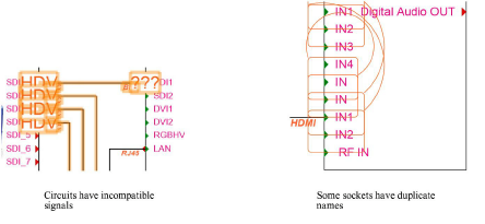

Vectorworks can automatically check the drawing (the current layer or all layers) for problems with sockets, circuits, devices, and signals.
To check the drawing:
1.      Select the command.
The Check Drawing dialog box opens.
2.      Select the drawing items to check and click OK.
When tracking down a problem, it’s helpful to avoid repeating tasks which passed successfully; deselect those.
3.      Drawing objects with problems are selected, and marked up with a special class to make them more visible. In some cases, additional drawing objects mark specific areas. Resolve the issues, clear the markup, and run the Check Drawing command again to verify.
